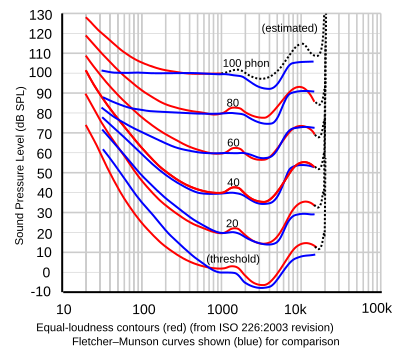

No, it's not just YOUR hearing. Its human physiology.
Fletcher Munson curves

Human hearing is a strange thing ... for most people, (and according to Fletcher and Munson), human hearing is most "flat" at 85db ... we perceive most frequencies equally.  Turn it up louder, and we become more sensitive to high and low frequencies ... almost like putting a "happy face" curve on a graphic EQ.  At lower volumes, we are most sensitive to midrange (where most frequencies in nature occur ... chalk that one up to Darwin).

The Fletcher-Munson curves, or equal-loundness curves, which were both derived from a series of experiments, show a consistant trend within the human population that were tested, which makes the information factual.  There will be deviations in response from person to person, but as a general rule, they show how human hearing responds to different sound pressure levels.

The scientific fact of equal loudness contours (though Fletcher-Munson is commonly cited, ISO 226:2003 is the much more recent and accurate version) is that (to my recollection) no one tested does better than a few dB of the curves. This is not surprising when you consider that the varying sensitivity at different levels and frequencies occurs because of physics and the underlying physiology of human hearing.
