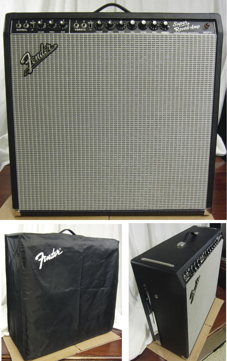

jackthehack said:
That's hilarious, I was thinking about this amp. I was talking with Jimmy Herring and he said it is his Super Reverb is his most favorite amp to play through, and he said Derrick Trucks thinks the same thing of his own Super Reverb. Oh bridging the Marshall - Fender divide. Will it ever come to be?
jackthehack said:
I had one of those - a 66 black face.
Used it on precisely one gig.  Sounded fine, but, but ...man.  I didn't need to streach my arms that much.
Sold it for a couple warmoths.
I've had good luck with the Stewart series of clean SS power amps. But they are just that - dead-clean - so if you're looking for power tube overdrive, you're kinda stuck. You can buy a bigger rack box... :evil4: Get one of those twelve-space jobbies, then you get to figure out how to fill it UP.
http://www.stewartaudio.com/products.php?category_id=6
Gregg said:
You've piqued my curiousity I need to go do some measuring, but I'm thinking that you might be able to mod the chassis and get into a rack mount, but it would obviously take up more than one space...
