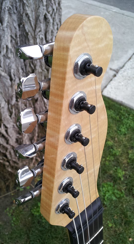

On this neck, I first dyed the birds eyes a dark amber, sanded back, and then dyed the neck a yellow golden orange.
People here won't steer you wrong.  They'll even tell you how to do it.  Maybe if you described what color you wanted, or what you were looking for someone here could give you a more productive response.  Maybe a picture of the neck or body you bought would be a start.
