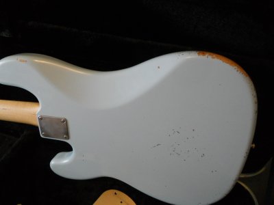

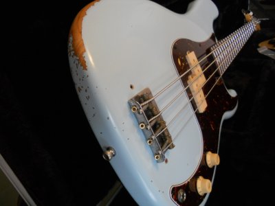

Since we're showing pic of distressed projects, I'll share a few shots of my "worn" sonic blue P-bass. The finish is so fragile on this guy, it practically started relicing itself (-think there was a thread a ways back about W's sonic blue stuff being pretty chippy compared to the other solid colors).
Rather than use steel wool, I used a Mr. Clean magic eraser; Steel wool, -even 0000, would have been too harsh IMO. It then went a few rounds with some car-keys, a wire coat hanger, and a few heavy set-downs on the garage floor, and the finish was done... wiped it down with brown shoe polish and then cleaned off (to leave some "grime" in the dents & nicks). Next the hardware took a trip through an acid vapor "time-machine", and the plastic knobs and 'covers got their mojo workin' with some dark-roast java in the basket of an auto-drip coffee maker.
