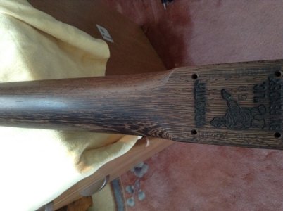

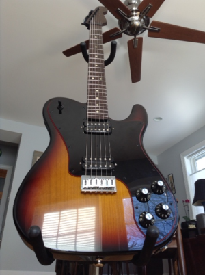

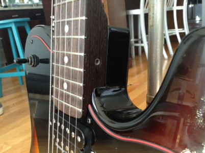

I love wenge, it feels so good ... it's nice oily wood, you'll love it.  It looks great as wenge on wenge.  Gives nice mids.  Though I'm currently getting a lot of love from Goncalo Alves.  It would be a crime to put a finish on it.
