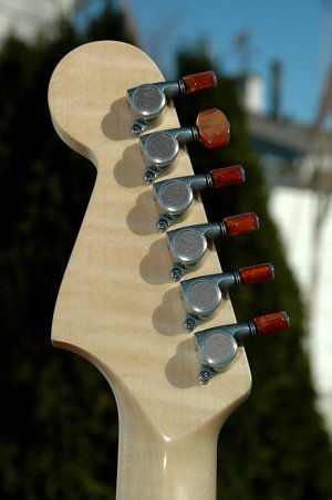

I love Hipshot tuners. I usually install them in the normal fashion, but I used the UMPs on a 50 year old neck I didn't want to re-drill. As Stratmania pointed out, hardly noticeable once installed. And Hipshot is just "up-the-road", in the NY Finger Lakes.
I've also used the Gotoh Trad Lock tuners. Nice hardware, and available in ANY stagger combination you might like, if you order them from a factory dealer. (I ordered mine 3,2,1) The only North American factory agent is Japarts:
http://www.japarts.ca/Gotoh/Gotoh-Products-SG510.asp#modlOrderingInfo
Just tell them what you want, and they'll make the arrangements. My parts were a factory special order, it took a while to arrive, but it was the only way to get exactly what I wanted. Good luck on your quest. :icon_thumright:

Steve_Karl said:
That pic looks great!
Are those MG-T Magnum lock Trad?
"2" is the middle range of height?
Thanks!
Yes, those are Gotoh Trad locks. I mis-spoke regarding their height, actually I ordered that set as 3,2,1, meaning 3x18.5mm, 2x20mm, 1x21.5mm. The order was specified to Japarts as:
"Gotoh, SGS510Z mini tuners, 1:18, with P8 Modern (tortoise) buttons, X-Chrome finish, MG-T locking posts (3x18.5mm, 2x20mm, 1x21.5mm). For a 6 in-line, standard right handed neck. (Tuners install on the bass, (Left), side of the headstock.)"
