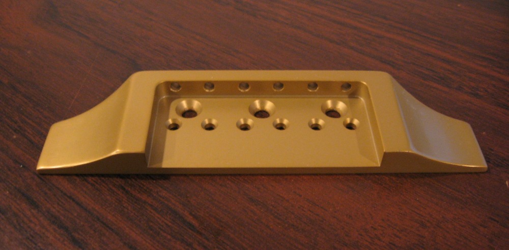

I received my new Scartozi bridge yesterday, this one in brass vs. the last one, which was aluminum. The aluminum looked really nice as delivered - all polished up and ready to go. But, silly me, I had it anodized gold so as to match the rest of the hardware. It didn't turn out very well. Quite pitiful, in fact...
Gold anodizied aluminum, no polish
So, you live and learn. I'm going to have to remove that finish and re-polish it to make it useful.

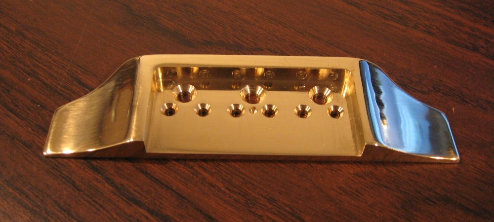

Throw some more money at the problem, and here's where we get to...
Polished brass - now we're talkin'!
But, as gold as that looks, it doesn't match real gold...
Not quite right

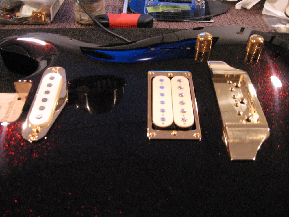

So, all that is to show why I need to get some brass hardware to match the new bridge, which is turning out to be much harder than I thought it would be. It seems a lot of stuff is made out of brass, but it's almost always finished somehow, usually plated in either chrome or gold, or painted black.

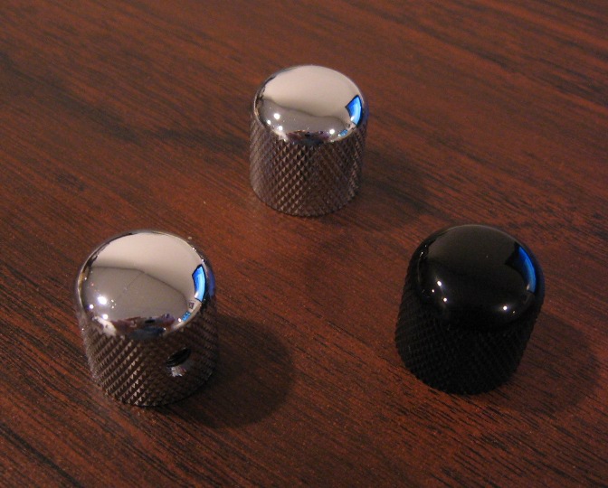

According to the directions, an acetone bath for about two hours would teach a piece of chrome plated brass a lesson. Ok, I've got lotsa acetone and a Pyrex measuring cup dedicated to such abuse, so let's have at it. I grabbed a couple chrome plated brass Tele knobs, then just to save time I grabbed a black one as well, thinking if the magic didn't work on chrome, surely it would work on paint.
2 hours later, no joy. Knobs looked as good as when they went in. 3 hours, 4 hours, 5 hours... dammit! So, I said to hell with it. I left them in until this afternoon, which was about 24 hours. Dumped the acetone, wiped down the knobs, and here there are...
...Laughing at me. Fargin' bastages!
All I accomplished was to get them really clean. Which actually doesn't surprise me, but there were a number of references and procedures that all said the same thing, so what is this? Some kind of conspiracy to piss me off? I don't know. Doesn't matter. All I know at this point is that acetone won't remove chrome or black paint from brass knobs.

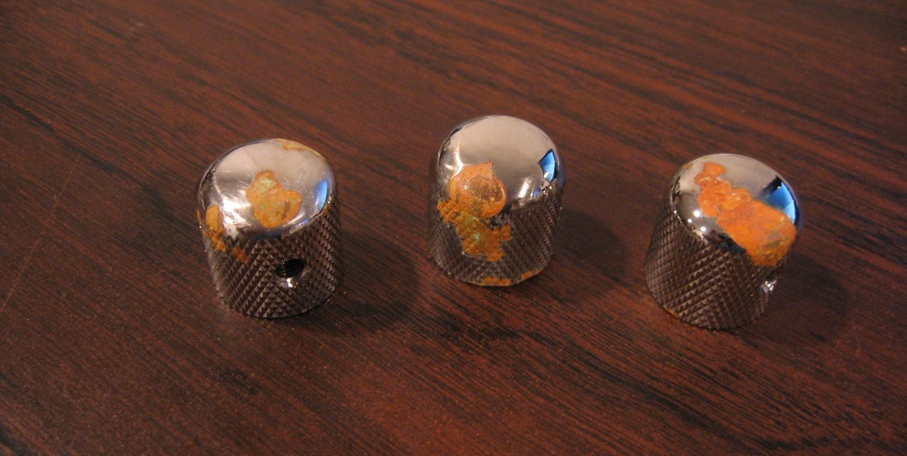

So, I laid out several thicknesses of newspaper, and hosed down my 3 victims with the evil oven cleaner. Waited the recommended 10 minutes, and went after them with an old toothbrush under a running stream of water. Not a dent. What the hell are these things made of?
Now I'm pissed. Laid the things out and hosed 'em down again. This time, I had a couple beers, couple cigarettes, took a nap, watched some cartoons, answered some email, etc. Not sure how long they were under the foam. But, this is what I got for my patience...
Yuck, he said.
It definitely took the black paint off the one, only to reveal that it was originally a chromed part. It did start to eat the chrome off, too. Unfortunately, it also had a pretty voracious appetite for the brass. At the rate things were happening, it was going to take about a week to get all the chrome off, after which the knobs would probably be pretty much dissolved as well.

What's weird is the chrome that wasn't affected still looks fine. It's shiny and smooth, just like it's supposed to be. You'd think it would at least look a bit etched. Where the chemical managed to find a way under the plating, it really ate the hell out of the brass. It's deeply pitted. Another anomaly is the threads for the set screws. You'd think they'd be an easy target, but they weren't affected at all. Nor was the underside of the knobs, or the hole for the pot shaft, which doesn't appear to be as heavily plated.
