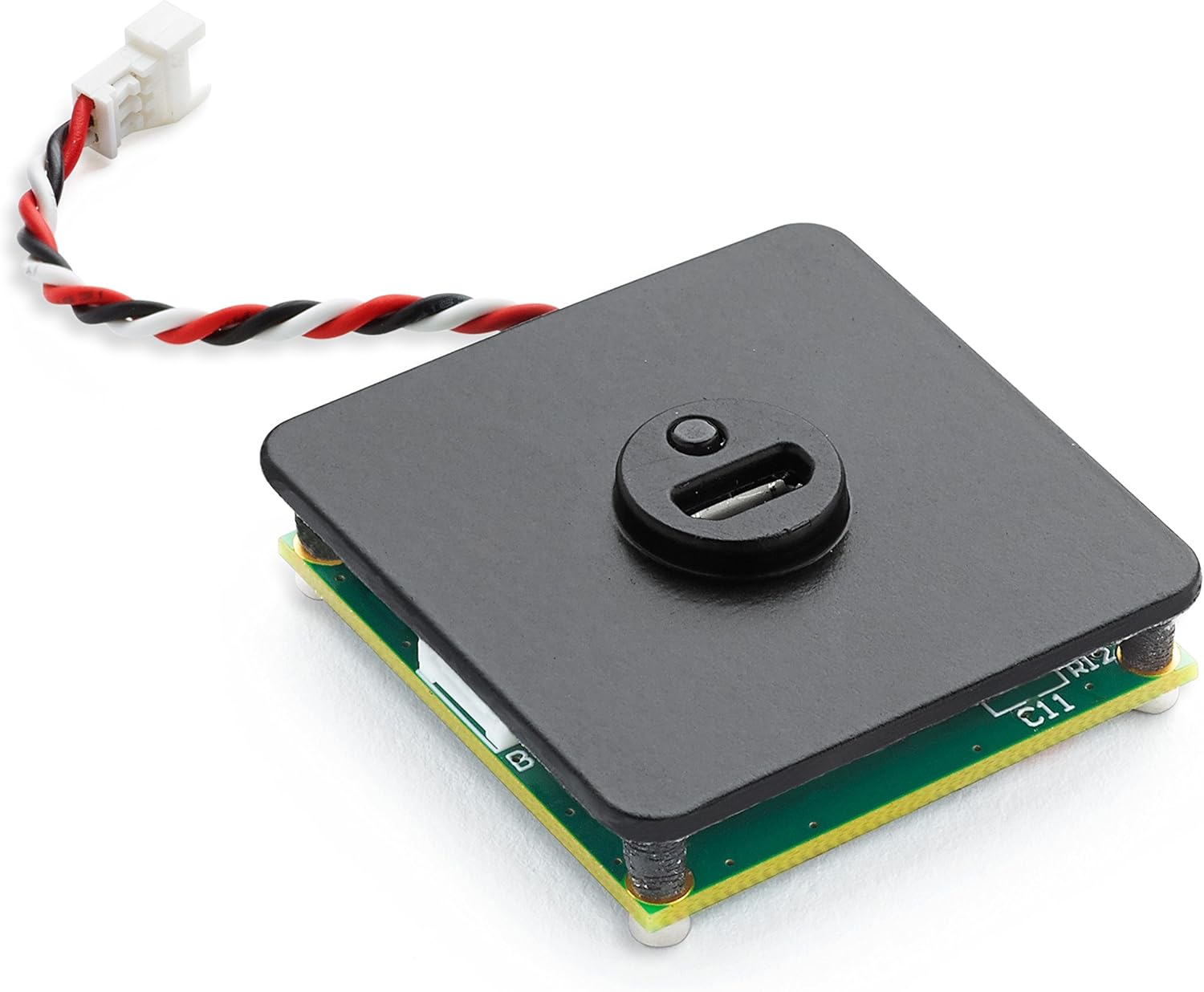

are the regal body rear access plates proprietary to Warmoth? or will a Gibson plate fit. asking because i want to buy a set of fishman fluence pups and a package that comes with a plate that doubles as a battery. Thanks!

https://www.proaudiostar.com/fishman-fluence-modern-humbucker-set-of-2-gold-les-paul-battery-pack.html?utm_source=Google_Shopping&gclid=CjwKCAjwnPOEBhA0EiwA609ReaKyY37G3dPsLScxkSnPTyKny4eJ_JaPY2mOhfRXj1qO3FDf3li4mBoCvyAQAvD_BwE

It's definitely different: radius at the corners differs and so does the angle between the sides:
That said, you could also get their 'generic' battery pack, drill a matching hole in Warmoth's cover and glue or use strong double sided tape to stick that pack to the Warmoth cover.
