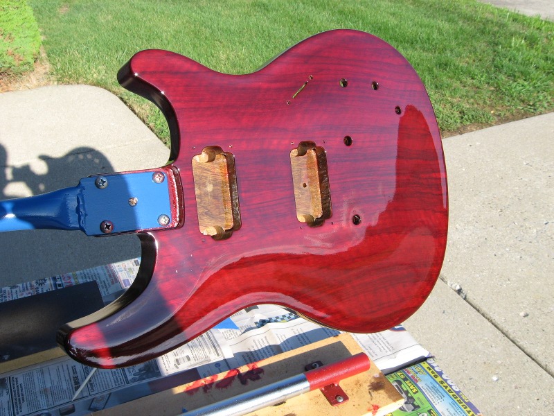

I put a transparent red finish over a chambered Korina body that my VIP is made out of, and used a Bloodwood neck with that...
Feels and sounds great. Bloodwood is a dense wood, almost like red Ebony, so it's not warm at all. It is heavy, though. Between the Korina and that Bloodwood, that guitar ends up weighing around 8lbs.

Thanks! That Bloodwood really burnishes up nicely. That's one that you have to be careful picking up, because it'll wanna slide out of your hand.
