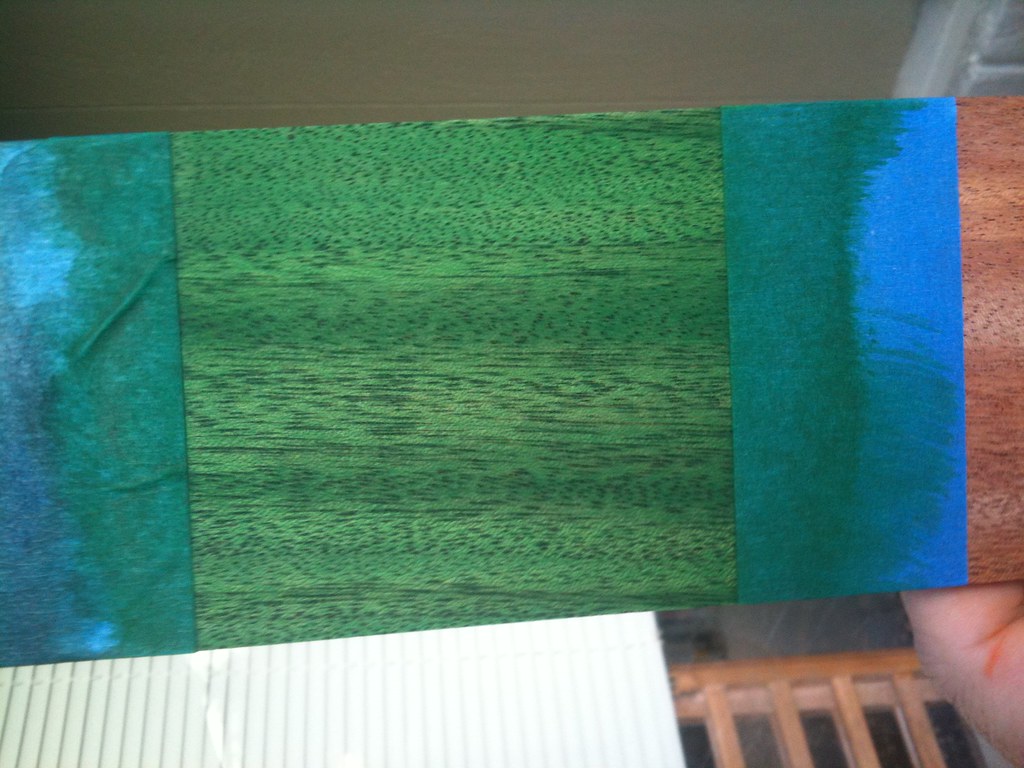

My road to the correct color on a naturally darker, browner species (mahogany, in my case) took me through TransTint land, where I, too, was frustrated by the dye's tendency to show brown through no matter what.  Eventually I ended up making a stain using universal pigment (Mixol, in my case) in a vehicle of 50/50 lacquer thinner and lacquer retarder.  In short, if it keeps going brown on you, the much larger particle size of pigment will mask the wood's darkening tendencies in ways the much smaller dye particles will not.  You can use the pigment in a stain such as I have demonstrated, or in shellac or lacquer or poly.
Here is my objective, ganked from the Carvin website 6 or 7 years ago:
Transtint in lacquer:
I tried bleaching the wood and trying TransTint in lacquer again and got this:
Finally I opted for the pigment stain, and got this:
Ultimate result:
