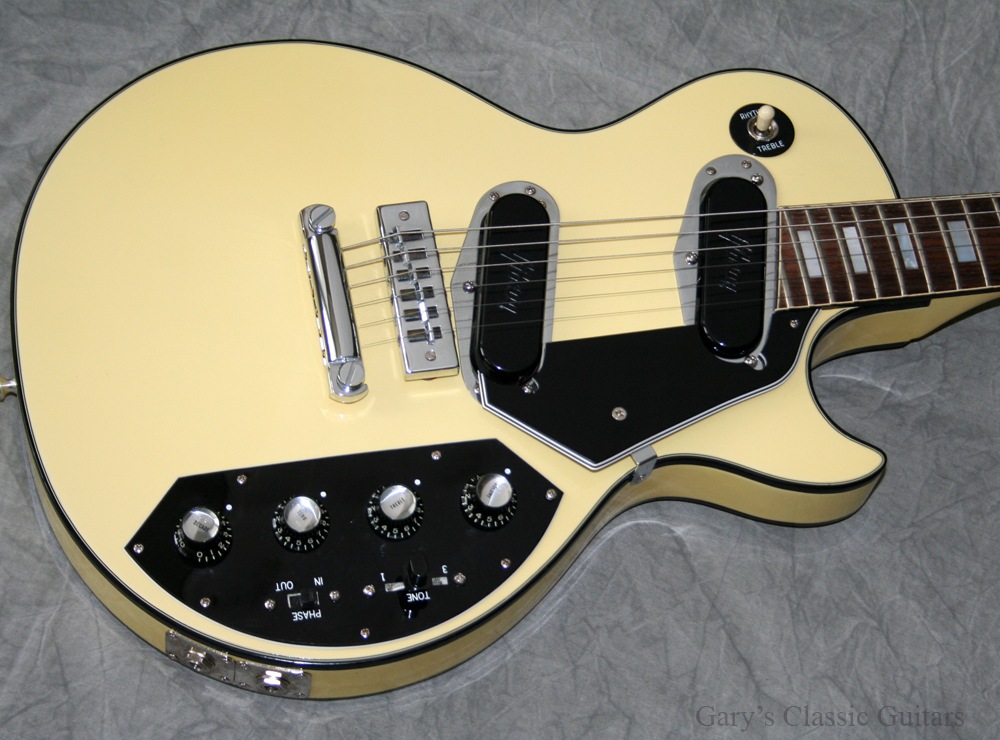

I thought the Les Paul Recording had XLR out(s) but apparently not. It did have low impedance pickups.
