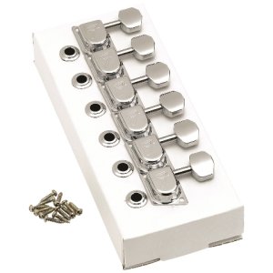

These tuners were what came stock on my original fender neck, and when I went to transfer them to my new warmoth neck they did not fit for two reasons. First, while fender claims that these are for 25/64, they are larger and would require reaming, they are more like 13/32. I'm OK with that. Second, however, is that on my standard Warmoth neck the tuning holes are too close, as such the flanges on the sides overlap, as such the tuners won't line up correctly.
http://www.fender.com/parts/tuning-machines/70s-f-style-stratocaster-telecaster-tuning-machines/0990822100.html
The fender website says:
Will not retrofit American Standard, American Deluxe or Standard series models, which is what Warmoth is based on.
