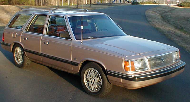

I know that there's a messload more to Canada than K-cars, Red Green and Trailer Park Boys. A day doesn't go by that I don't play at least one April Wine, Kim Mitchell, Max Webster or Rush track. Seriously some of the best and hardest working musicians have come out of the great nation of Canada, and sadly have not received nearly half of the recognition that they deserved for the hard work they put in. Many of the chops I know I didn't even know until I was exposed to the music when I would listen to Toronto's Q107.
As a matter of fact, "Sign of the Gypsy Queen" is playing on my PC right now.
Trust me, the last thing I'd ever do is bash Canada--I have too much respect for the nation to do that.

I didn't take your post as bashing Canada at all. Just thought I'd throw up some racing examples.
And theres nothing wrong with a K car, it's a nice reliable automobile........... :icon_thumright:
