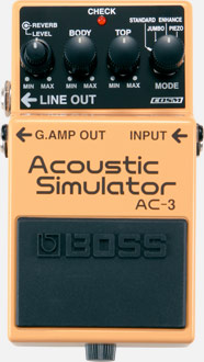

Or ... you could save yourself a lot of headaches and get a Boss AC3 to keep stuff really simple.
Connect your Tele (wired as a normal Tele) to the Boss pedal and - presto - you've got a sound that mimicks that of an acoustic.
Just like the piezo pickups mimicks the sound of an acoustic. :icon_jokercolor:
