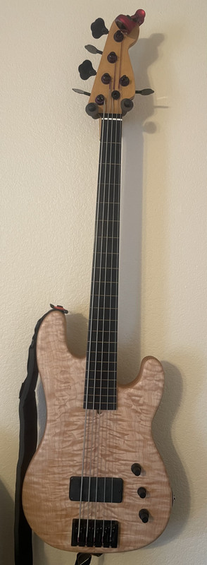

After yet another year of doing nothing with this bass (other than playing it occasionally) I finally decided to wax the body with Howard's Feed-N-Wax
...and all I can say is, why did I wait so long?!?! The process was ridiculously easy, it required no special tools or techniques, it was quick, and most importantly, the wood looks fabulous! Really makes the grain pop.
Just gotta find one replacement knob for the one that went missing 4 or 5 years ago, and this instrument will finally be done!

Got the knob, now it's done!!! Yay :::happy dance:::
Already used it on a studio session this afternoon, laying down tracks for a film score by composer Alexey Artemov.
