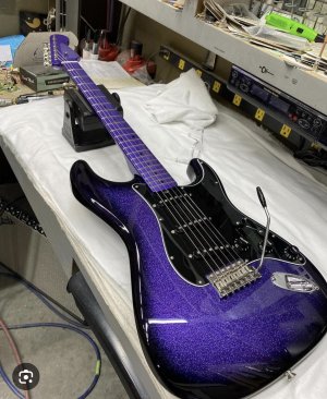

Hi guys,
I came across a custom shop painted neck & fretboard and I am loving it! I’m wondering if there is any particular process to painting the fretboard including the neck? Is it as simple as sanding and painting like any other part?
Thanks!

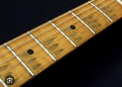

There are definitely examples of transparent “painted” fretboards, and I’ve seen opaque white as well. Many times transparent paint is just a tinted clearcoat, so anywhere you can spray clear you can spray a transparent/tint. However… think of those worn maple fretboards that are worn through the lacquer. Unfortunately you’ll wear through the color in the same manner.

Thank you to everyone who responded. I originally asked this because I was dead set on buying the pearl magenta Custom Shop, but after further thought, I think it’s better that I didn’t go for it. It’s so pretty though. Maybe one day.
