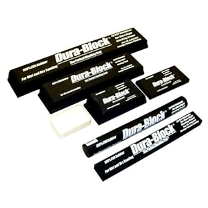

I always sand by hand. Power tools will tear through the finish much too fast, particularly on any kind of edge or transition. It's good idea to have a hard rubber block for the flat areas, and some shaped ones for some contours, but you shouldn't need much more assistance than that. Dura-Block has some nice pieces...
That set should cover just about anything you'd do.
Also, I rarely use anything rougher than a 320 grit unless I'm dealing with raw or rough-cut parts.

Orbital sanders are nice but only if you are comfortable and know how to use one.  The problem with orbital sanders is a lot of people angle them without realizing it and you work against yourself creating waves.  You have to keep it flat or you aren't doing any good.  Especially after clear coat (you will be really sorry if you tear through the clear coat right after you finish).  The durablocks are nice and you have a lot more control and can take your time.
