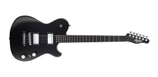

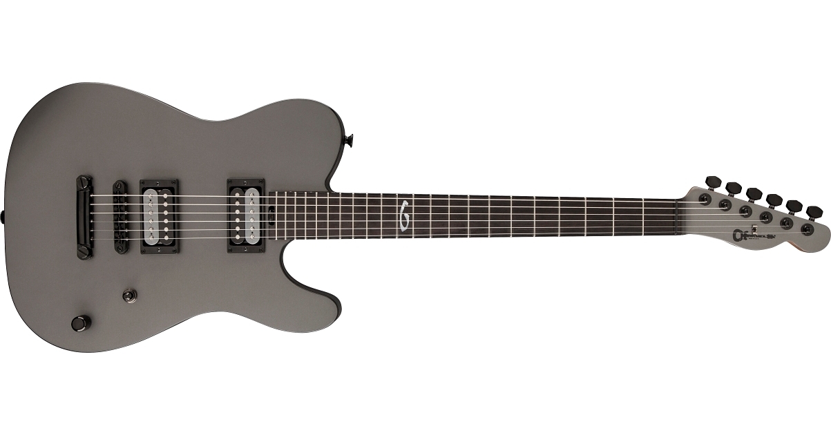

I was inspired by something like this

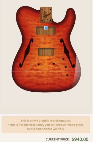

I think the Gotoh Wraparound bridge looks better on Carved Top Telecaster Body, as this one I designed on their site.

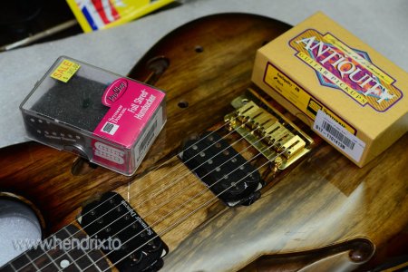

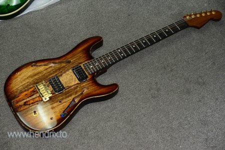

I'm curious on what fretboard wood you put on the top of your rosewood neck ?
The Rosewood neck I bought from the show cast got Ebony fingerboards, and this bright tonewood should balance the warmer tone of Korina and Rosewood.
Also, Ebony is very smooth, fast feel like maple, but in the dark near black colour and No need finish.
I have a not finish thread here : https://unofficialwarmoth.com/threads/double-f-hole-strat-with-wrong-hole.27517/
The Rosewood neck + Ebony fingerboards is the one on Red Carved Top Telecaster Body, it feel too "darker tone" on Mahogany Carved Top Tele, should be too dark for single coil pickup , but work well and long sustain for Korina body + H-H Pickups , the bridge PU is Seymour Duncan JB Antiquity , work well on this guitar , Neck is seymour duncan full shred, which I don't like , not sure what to change yet .
not finish photo here
