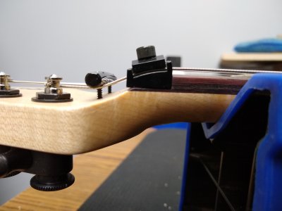

A question on Showcase necks I have is about Floyd Rose nut prep. I know it is only available on modern construction, but will a showcase neck that has a number of options for nut prep end up with a flat shelf under the whole of a FR nut or will part of it protrude?
        ¦----¦ nut on shelf.
        ------ shelf
      /        slope to headstock face
    ¦----¦ nut protruding
        ------ shelf
Anyone got any photographic examples?
I would rather find out ahead of time...how it would look.

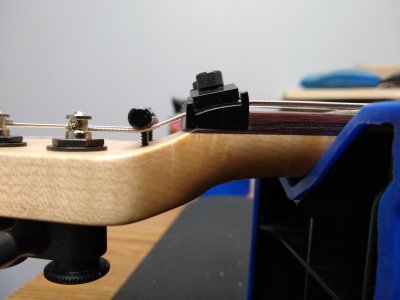

Not sure if this is what you're asking about, but the below pics are of a Showcase neck that had a Floyd Rose prep done on it.  The nut is an OFR nut, not some aftermarket piece.  So, what you see below as far as fitment would hold true for an OFR nut, not sure about aftermarket nuts.
On this one, there is a slight overhang of the nut out over the headstock.
Many thanks that was indeed what I was asking about. Of course structurally and functionally there would be no issue just something to be aware of visually.

If you spec a Floyd nut on a showcase neck there will be a slight overhang, because the slope from the surface of the fretboard down to the face of the headstock has already been done. The slope happens closer the nut on standard nut necks than it does on Floyd nut necks.
If you spec the neck build-to-order there won't be an overhang, because we know to move the slope to accommodate the Floyd nut.
There is no structural or functional difference, only visual.
