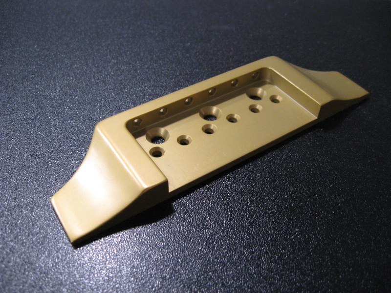

Got the bridge back this week. Not as happy as I could be. Pretty pissed, truth be told. But, check it out...
Here, we're looking as good as we're going to. Clearly, this is not gold Looks more like an olive color to me.

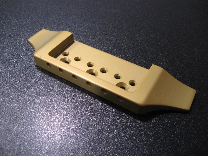

Another angle of it...

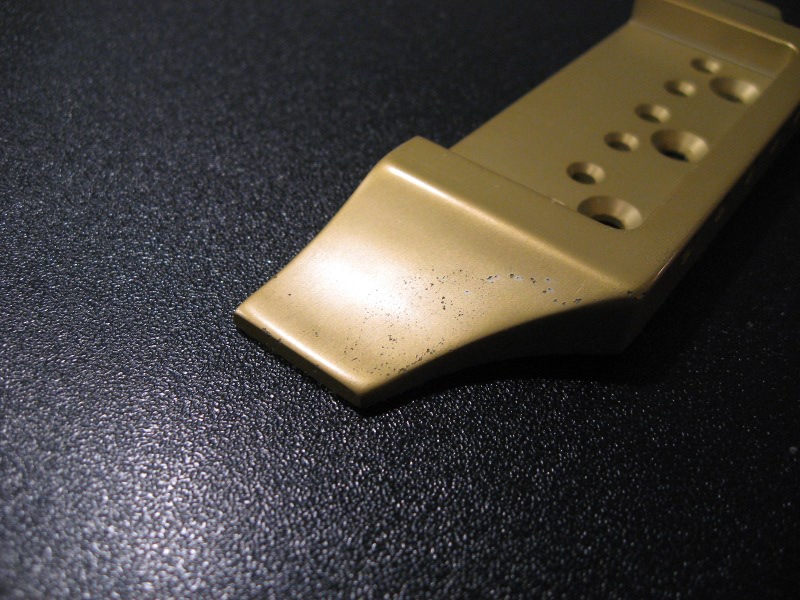

And then, the feces hits the air circulator. What the hell is this? Apparently, there was a some contamination
of the part with something non-conductive, so the process failed. (Anodizing is an electrical thing...)

The bridge had a good polish on it before anodizing right? If it did then they really did a poor job not to mention letting it out the door with the contamination. They should have redone it.

It was well-polished going in, and part of the anodizing process is supposed to be cleaning the part because anything that prevents electrical current flow will result in a poor finish. So, this was just a bad job, plain and simple. Then, regardless of what step(s) got skipped or overlooked, the results demanded a re-do that clearly didn't get done. So, bad shop. Bad Shop! Probably a buncha union whiners, wondering why they can't get paid for doing nothing, or why they can't get paid more than they are now for doing a half-assed job. It's no wonder Detroit's in the septic tank.
