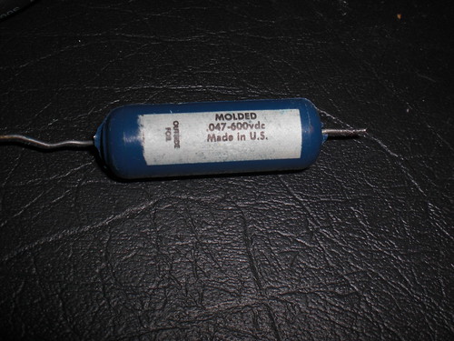

The death cap is out:
MUYFUE said:
Ok, I'll just ask...cause I don't know...
What is this Death Cap?
Quite simply, the Cap of Death.   :icon_biggrin:
It's a cap in many of the old Fender circuits tied to the polarity switch (before they had earthed
power cords) which, should it fail, has the potential to use *you* as ground while you touch the strings.
.047uF 600V is the common value found (as shown in his pic).
Dang...Death Cap indeed  :sad1:
