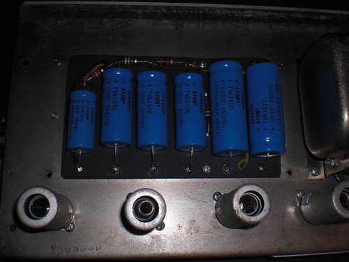

please, oh please tell me he used the big blue Sprague TVA ATOM filter caps... please....
:icon_thumright:
Edit: Is the last one supposed to be reversed like that?  The layout I'm looking at doesn't include the filter caps.
Edit2: Seems to be correct, I found a few other pics of filter caps on Bassmen and they're all like that.
Yep, they are supposed to be reversed.  The caps are actually stacked on top of eachother in parallel with a voltage divider to effectively double the voltage rating.  That is, we take two caps of value C rated at voltage V, and we make them look like one cap rated at 2V.  Sadly, this decreases the capacitance to C/2, but in the late fifties/early sixties you did what you needed to do with the caps you had to work with :icon_thumright:
