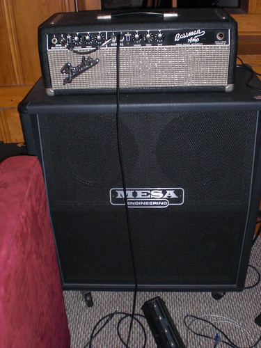

What speakers in that box? EVs would be crystal clear in that rig, but I'm guessing you went for Celestions or Webers?
Nice amp.  :headbang: :icon_thumright: :headbang1:
 Now, you need to get a better cab for it  :icon_jokercolor:
It's got 4 V30s.  I'm running the amp into half of the 4x12 (which is 8ohm mono) and it sounds great :)

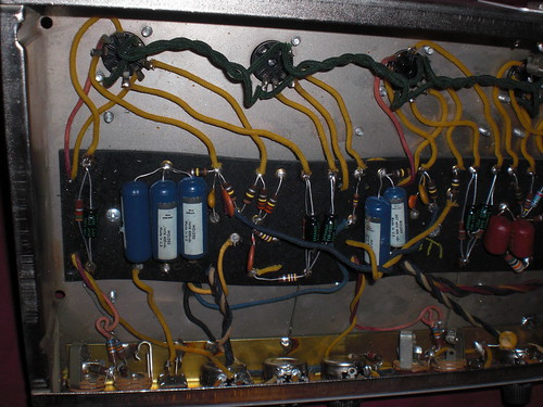

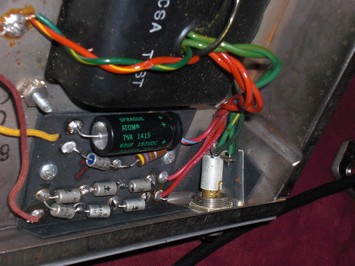

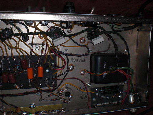

Cracked it open tonight and it's not all-original like I thought... I assumed it was because of the 2-prong cord and stock bias.  It's got new filter caps and the screen resistors have been upgraded, so that's nice.  There are a few new electrolytics and Orange Drops inside but also many original caps.

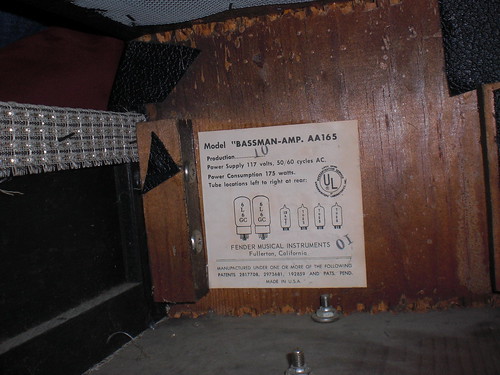

Tube chart says AA165 but it's definitely a AB165 circuit.
It is a 100% stock circuit though, including negative feedback, "balance" bias, and "death cap" (which is the original!  :o)
Gee, I wonder where it was last serviced
I will change the bias circuit to the sane kind, add 1-ohm resistors for biasing, get rid of the death cap and add a 3-prong cord.  Then I will play it for a while before I do any "real" mods...  :party07:

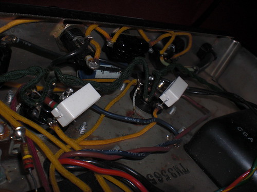

Yep that's the real thing all right.  Nice and clean as well.  The cap job is fine, and those two orange drops replace the two caps in the phase splitter, which are common failure points for this amp.
Yea, I'd get rid of the death cap  :icon_biggrin:
