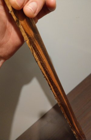

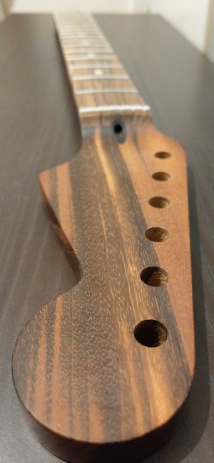

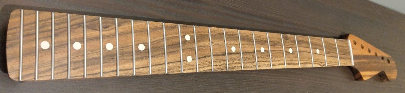

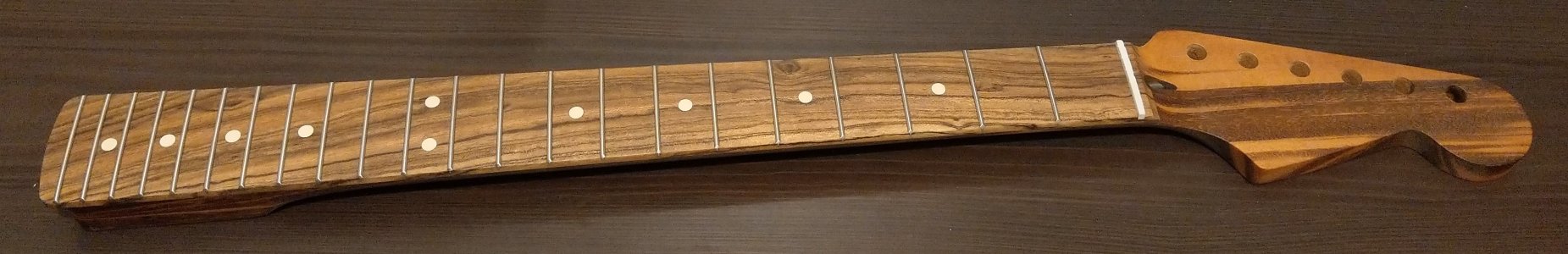

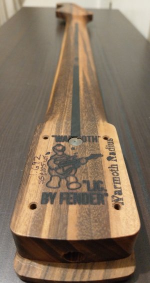

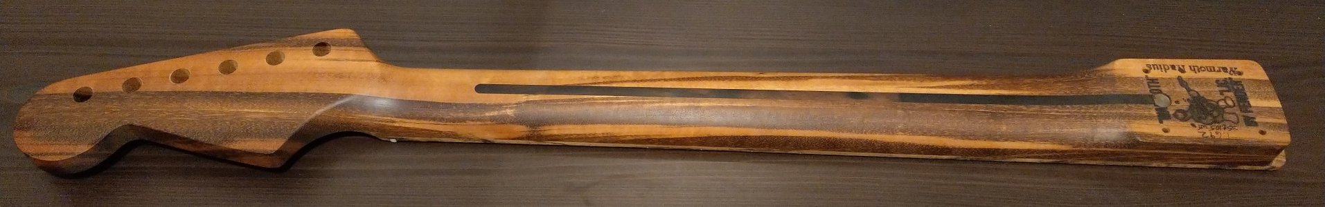

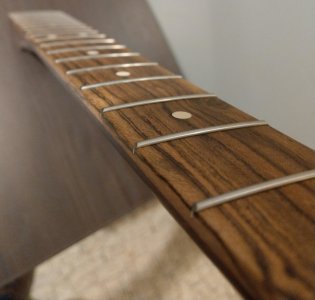

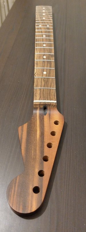

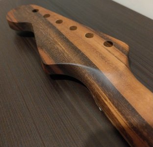

Puyallup, Washington to Melbourne, Victoria - frets and all - in 8 days. I'm impressed.
See the attached files for crazy figured goodness.

Thanks all. I'm super pleased.
It's funny, I bought it mainly because I loved the look of the neck, thinking "oh well, the fretboard will darken up eventually". Looking at it in person, I'm now thinking the fretboard is my favourite bit.
Now to source some staggered tuners (Hipshots, probably), and figure out if it'll fit the body I have (MiM Deluxe - will need to drill the offset hole for the recessed heel).
After that, it's finding out if the staggered pole noiseless single PUs in my HSS set will play nice with the new setup, or if I have to swap them out. Giving serious consideration to the Rio Grande Dual Calibrated Cuatro loaded pickguard... eventually.
A thousand congrats to you, that is a prime neck. Whenever I look at unique choice Bocote fretboards on the Warmoth site I get weak in the knees. Enjoy that on your guitar. One of the best things to happen to Melbourne in a while is you getting that neck.

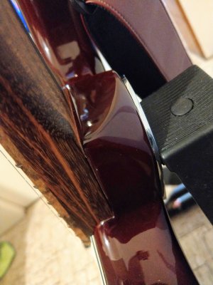

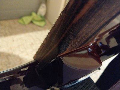

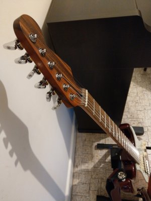

Finally got this fitted.
Rather than messing with it myself, I took it to someone with a good reputation (Paul Dalby at Music Swop Shop, for those in Melbourne), and it looks/sounds like he's delivered the goods. The fret buzz, intonation, and overtone issues are gone.
Interestingly, he's shimmed the neck slightly to lower the neck angle. As soon as I saw this I remembered the setup with the old neck had half the the saddles wound all the way up. I don't know anything about anything, but maybe this means that the problem this whole time was the body's neck pocket?
Whatever the case, this was the first tech to get the bottom of things and make it sound like a guitar. I am, as we say down here, stoked.
