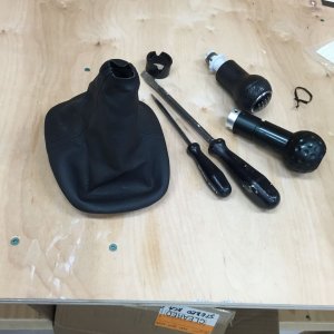

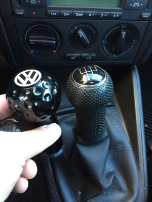

0 - test fit/look at/admire the new one. Looks snazzy!

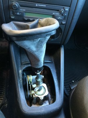

1 - getting the boot off the car is a piece of cake.

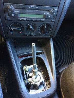

2 - getting the gearknob off was a pain in the ass. You need to get a steel ring off the bottom before the knob will let loose. I didn't want to destroy the ring as I wanted the option to go back if I didn't like the new one. It took a lot fiddling, but success!

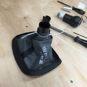

3 - Once in the shop, getting the boot of the knob was pretty easy

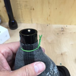

4 - I tried to use tiewraps to attach the boot to the new knob, but the end-points made visible buldges in the leather. In the end I ended up using solid core hookup wire. Worked just fine.

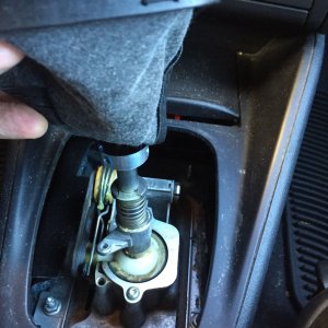

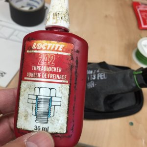

5 - I never want the knob to come off unless I want it to come off! A little locktite is your friend

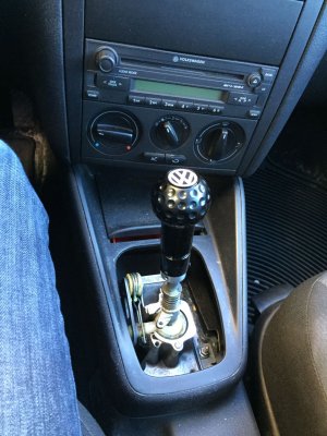

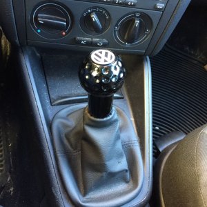

6 - after all that, the knob went on very easily. Hey baby! check out my knob....
