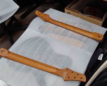

Ah, thanks Fat Pete.  Guess I haven't been keeping up with this forum for a while.  For those like me, here's a glimpse of the Meadow headstock.
