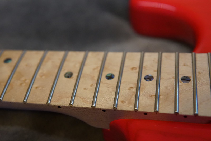

So I went to the UPS store to pick up something else and lo and behold, out comes a neck box. No shipping notifications, no nothing from Musikraft. Nervous as hell from the other thread where the Musikraft neck has been Fubar'd the last two times, I open my box. It's absolutely perfect, the nut lines up perfect (the two rear bolt holes DO look off center from the neck, but i guess that's how it's supposed to be, my other FR nuts are top mounts). The nut is perfectly square with the neck and the string spacing is perfect on each side. The frets are perfectly level and the ends are rounded, as well as the fretboard. I had them lightly roll the neck instead of their "heavy" rolling, fearing strings falling off the board. The light is great. It feels smooth and broken in with no hard edges. All frets are perfectly seated and beveled on the edge. Time will tell when stringing it up if any of them are prouder than the others, but it doesn't look like it by using a metal straight edge to guesstimate it. It fit super tight in the neck pocket with no gaps on the guitar and bolted right up. I got the EVH asymmetrical carve and I was curious how i'd like it, but it feels awesome. Very natural in the hand. The birdseye is moderate, just how I like it. Too little and i feel it's a waste of money, too much and the guitar looks like it has leprocy to me haha. But this is just right.
This one looks weird, like the neck is stained or something in one spot, but it's just the lighting. It's flooding outside or i'd get better pics.
Damn that looks great together! Really love the look of that neck. Glad it worked out great for you.
That does make a fine instrument. Glad to hear your order was as should be. Looks good. :icon_thumright:
Happy to hear your neck came out right. Very nice to hear you're pleased.  :icon_thumright:
Nice. That combination worked out really well. Congrats on a great build.
