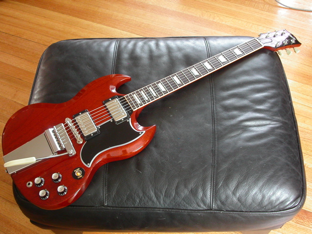

This is the headstock from the L5S in my sig...

Thanks again for the help.  How is the tuning stability of the guitar you showed the pic for, when using the trem?
It's quite good, but not perfect since it's a Bigsby. If you were to use a more modern design vibrato bridge (2 point knife edge fulcrum), I can't imagine you'd have any trouble. I don't have locking nuts on any of my guitars, while they almost all have vibratos. Between locking tuners and a well-cut nut I can do what I want.
