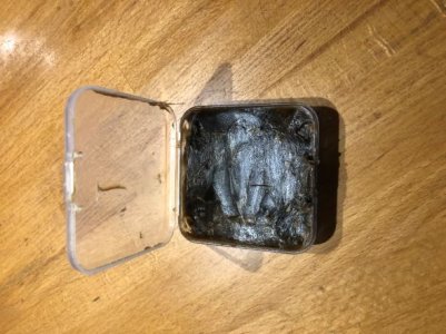

ooh will you look at that! Guess who remembered they had an old unused wax toilet ring buried in basement? Scraped off a hunk and put in container for future use! Tossed the rest.

BTW-the wax on mine was dark from the start, was a fancy ring! :laughing7:
