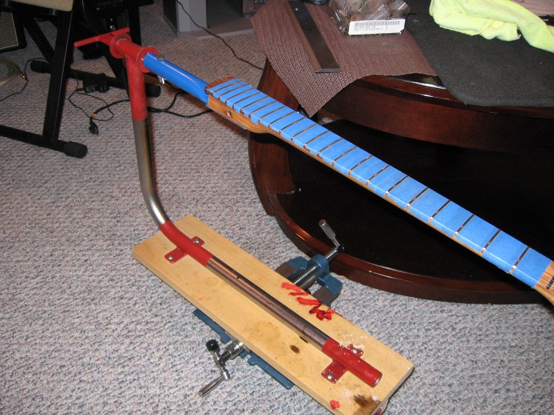

The whole operation is a lot easier if you have a painter's stand or a vise. That way, you have access to everything and lots of room to buff. Here, you can see where I'm using both...
It would actually be easier with just a vise on a benchtop to clamp a neck attached to a painting stick. But, I don't have a bench in the basement, and it's already too cold here to work in the garage for any length of time.

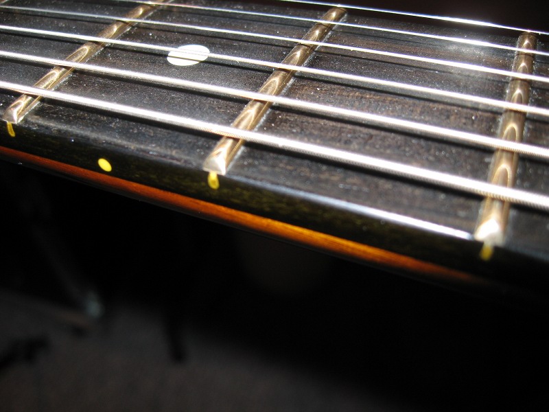

Here's a shot of a fret set that has been finished using the methods I describe...
It's tough to get a good shot because in macro mode you end up with depth-of-field issues, and I had to use the flash so the anti-shake feature works, which makes the thing a bit harsh, but you get the idea. Frets are levelled, then crowned, then dressed, then polished. That neck is Warmoth Pro Ebony over Koa with a vintage gloss polyurethane finish. The finish goes up the sides of the of the fretboard itself, but you don't see any jagged edges there at the break. In fact, you don't really see a transition at all.
