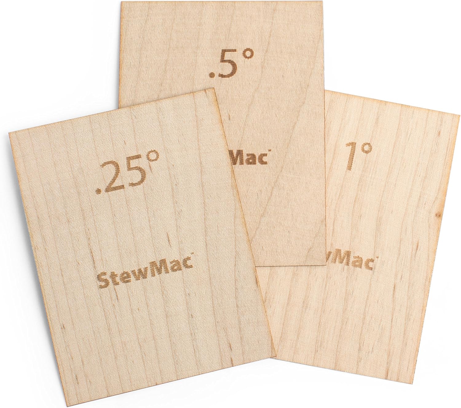

I ordered a set of neck shims from stewmac, going to try that first before doing anything more drastic. They haven't arrived yet, must be stuck in customs (I'm in Canada). Hopefully net week!

Re Stewmacs shims; the pre cut and drilled shims are not reversible as the neck pocket is slightly tapered but they sell 'blanks' to tailor. Pity the don' make the reversible option as reading the reviews on the shims there is plenty of demand for shimming the neck end of the pocket.
Not sure what you mean by "reversible", but these will give you a nice predictable angle in whichever way you need to go, but you have to do your own drilling and corner adjustments for fitment.
They're kinda pricey for what they are, but hey - if they work, they work. Tough to argue with success.
