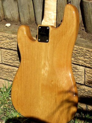

The back of my lacewood topped bass is clear glossed alder. See if you like it, I do personally but not everybody will.

That's pretty nice.
I've not seen an absolutely clear finish on alder that I've particularly cared for, but their have been a few translucent finishes I've seen that looked ok.
