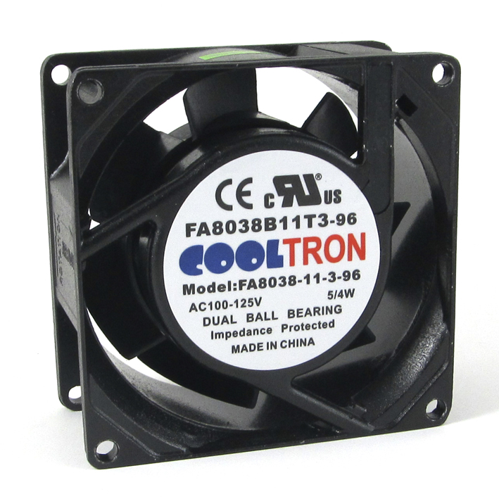

The only real problem I have at this point is – the fan in the ADA is ridiculously loud. Lousy for recording in that I pick up the fan noise unless I seriously CRANK the amp and back off the gain on the cabinet mic (SM57) thus lowering the overall noise floor. Seriously -- cranking that amp is fun, but it takes my cats a couple days to get over the trauma and re-appear. That and makes monitoring in the phones difficult (I have a small home studio with little to no isolation).
So, my question – wanted to see if anybody has any suggestions on changing out the fan for an old ADA tube head with a durable replacement that is dead quiet? Also, any comments/suggestions from those who have a similar set-up or are using/have used the Rocktron Piranha pre-amp (you don’t see them around much these days).

Totally guessing here, but you could probably find a quiet replacement fan at a computer retailer or online source - try frys.com or microcenter.com as starting points.  The spec for the fan has gotta be printed on it somewhere, if you feel up to opening the box, otherwise find a good local tech.
Maybe the schematic is available online, too - Google is your friend.
I have a similar issue with my Yamaha T100C combo - it has a fan that's obnoxiously loud.  I had my amp guy (Val King at King Amplification in Los Gatos, California, if you happen to be local) install a switch to turn it on and off.
Good luck -
Bagman
Those little muffin fans are notoriously loud while barely moving any air, and generally have the life expectancy of a fruitfly. You need to spend a few extra dollars and buy either a Papst, Scythe, Sharkoon, or Noctua fan. They're not terribly expensive, but they'll run $15-$20 while your standard fans will often be $5 or less. They're quiet, though. All but silent, usually under 25dBA, and they typically use ceramic bearings so the MTBF will exceed 100,000 hours. Find out the size you need, and go here.
We replace fans a lot around here at work.  I essentially work in an over glorified barn, so it is not the nicest on some equipment.  You just have to get the proper voltage, air movement, and noise level.  One trick that people used to use was a 24 volt fan run at 12 volts to drop the noise.  You get half the flow, but...  With todays fans for computers, you should be able to get something to fit that is a lot better than the old stuff, with regards to both noise and airflow.

Thanks for that link, I remember when I had it open a year ago to clean the volume pots I looked at the fans -- I think there were two of them bolted together, pushing air out of the front of the chassis. Don't remember the size, voltage (probably 24V) or cubic FPM spec, have to open it up again and check, which is easy to do once I get get that monster out of the road rack (it weighs like, 40 lbs or something).
I'm thinking maybe I will get two fans of identical spec (same FPM) except quieter and find a way to mount one in the front of the chassis pulling air, one in the back pushing. One of those things that's not particularly difficult but you keep putting if off, you know?

Most every amp has a 6 volt tap for the heaters on the tubes.  If you get a 12 volt fan that moves enough air, you can run it at half power.  Since it already has the fans, they should have isolated them so they don't make a ton of electrical noise.  Other than moving in and out of the rack, it sounds like a fun thing to do.

That's the secret: flow. Lotta guys (and some manufacturers) will put in a half-dozen fans, but all they do is blow around the hot air. The hot air has to be removed and replaced with fresh air. Turbulence does nothing. You've got to have makeup air and exhaust, or you're not getting anything done.
Follow-up, I opened the ADA T100S head and took a look:
It's a 80mm 115VAC fan by FlowMax who are no longer around. But, I located a fan with identical form factor and specs here:
http://www.acinfinity.com/115v-ac-fans/80-mm-fans/115v-ac-cooltron-fan-80mm-x-38mm-ls/
which is a 28dba fan, slightly reduced speed but quieter and I don't think the lower speed is going to cause a heat problem. I have a temperature probe on my multimeter, I am going to measure it before and after and see how much of a difference it makes.
28db is pretty quiet. Looks like there's room in the front to mount a makeup air fan as well. Make sure the rear is actually an exhaust and that would get a forced cross-flow going, which would be a Good Thing.
