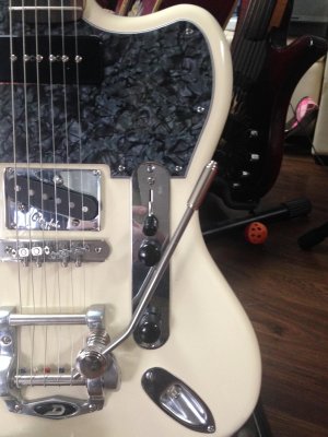

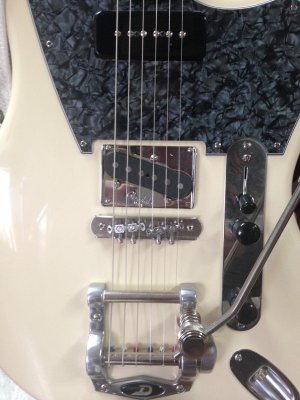

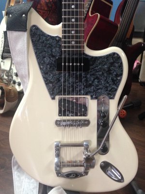

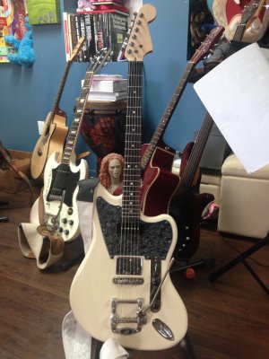

Hello, everyone! Long time lurker, first time poster :)
This is my second guitar build and my first Warmoth build. (I've done many modifications and built many many pedals and several amplifiers as well  :) )
This is pretty-much my dream guitar :) I wanted more Jazz than Caster, hence the neck, neck p'up, bridge and trem.
I know the strat-style output jack isn't very popular, but I can't stand reaching way down under to plug in. Lots of other little things that I got to do just my way :)

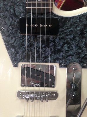

I wasn't sure how the JM-style bridge would match up with the tele-style tone-ring, but I am super happy with how it came out :D
Specs:

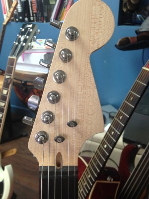

  • Warmoth Jazzmaster neck (Ebony on Quartersawn Maple), SRV profile, MoP dots, TUSQ-XL nut, unfinished because that's how I like it.
  • Warmoth Jazzcaster body in Antique White, routed for Tele Bridge and P90 neck, and contoured heel. I drilled it for a JM Bridge because it wasn't an option on the site.
  • Warmoth Pickguard
  • Bare Knuckle Flat 50 Bridge Pickup
  • Bare Knuckle Supermassive P90 Neck Pickup

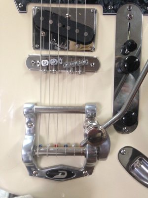

  • Duesenberg Diamond Tremolo
  • Mastery Bridge
  • Glendale Guitars Cold Rolled Steel Tone Ring
  • Emerson Custom Shop Pro pots (500k)
  • Emerson Custom Shop .033uf PIO cap
  • Fender Custom Shop 4-way switch
  • Ernie Ball black Tele knobs
  • Fender Locking Tuners
  • TUSQ-XL String Trees
  • Warmoth hardware (output, neck, and control plates)
  • Fully shielded cavities and wiring
I had a few small issues with the build (that I was able to easily overcome with some elbow grease.) First off, the control route needed to be about 1/8" longer on the tone-knob side for the pots to fit and for the control plate to fit into the pickguard even though the pickguard was flush against the bottom of the neck. So I routed out about another 1/8" to make that work. Also the neck-angle was way too flat, so I sanded down the heel diagonally (about .040" on the headstock side) to put a nice angle in it.
I just need to do a fret-level now, but even without that, she plays, looks and sounds fantastic. Bright and punchy.
I'm totally jonesing to build another now :)
Thanks for reading and looking!
.o0O~Delilah~O0o.

Very nice job!
What is it about offset waist Fenders that make nothing fit? I've built a few of them, and they're always a pain in the shorts, needing additional routing and careful attention to cover placement.
I see you used a Mastery bridge - good choice, albeit a bit pricey. Also, the wang bar choice is good as opposed to the nightmare that is the typical Fender offering for that model.
I'm sure you're very pleased. That's gotta be a fun fiddle.
Welcome to the land of the de-lurked.  We're glad to have you on board.
That's a handsome fiddle you've assembled there.  That Deusenberg Bigsby-oid vibrato bar musta been a pretty penny.  Good choices all around. I love a Tele with a P90 in the neck, never having been happy with the standard offering.  If'n I were you, I'd gloat about having that axe.  Well done.

@Cagey, I did spend a good bit on the Mastery Bridge, and whole build really- this was a "spare no expense" sort of project to build my dream axe. I think the parts all-together totaled up to $1200. So for the price of an American Standard I got Custom Shop quality :D But I did save some money importing the pickups and trem myself.
@Bagman, I imported the doosey right from Rockinger in Germany. It was actually quite reasonable and comparable to a Bigsby. They've (they being the EU) stopped charging VAT to the US for online purchases so I think after the exchange rate and shipping I paid only $140. They shipped it FedEx and I had it in 3 days :)

Q is that a strat neck mating a tele neck body rout? Is the pick guard covering the gap?
@Rick, nah, it's a strat pocket.  Like I said, I wanted more Jazz than Caster ;)
I'm not a big fan of tele headstocks, TBH, and I figured this would give me more flexibility down the line- as I like my necks unfinished, it may warp on me (although the ebony fretboard and the thick SRV profile quarter sawn maple will probably go a long way towards preventing that.)
