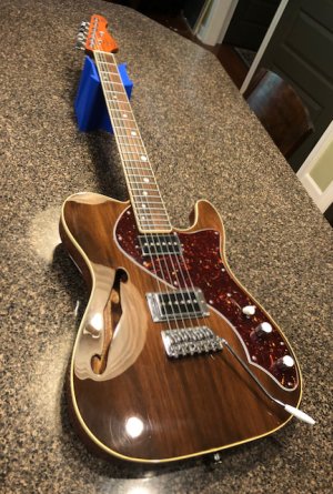

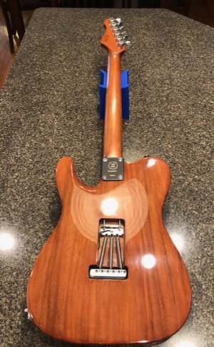

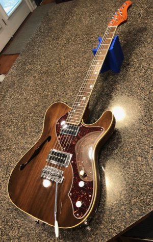

Hi,
I was commissioned to disign and build this for a friend after he saw my I Warmoth 72 P-Bass that I had finished over the winter.  Honeltly, the hardest part was giving it to him when I finally finished :)
Build Details:
Stained Walnut Gloss Nitro Body: Warmoth Slimline - Walnut top, Mahogany, cream binding
Stained Mahogany Satin Nitro Neck: Warmoth Mahogany, , Cream binding
Fingerboard: Ziricote Fingerboard, Nightswan inlays
Pickups: Gibson P94's (These are friggin awesome)
Bridge: Babicz Full Contact Strat Tremolo
Tuners:  Gotoh Locking
Custom Neckplate
​Electronics: ​Tele Solderless Wiring Harness Bill Lawrence 5/w Blackbeauty .047 Alpha - (Very versatile setup)
1 Neck
2 Neck & Bridge
3 Bridge
4 Bridge & Neck half out of phase
5 Neck with bass cut capacitor
This Guitar exceeded my expectations in all aspects: looks, sound and play-ability.

Came out great! The best thing Gibson makes are their pickups!!
mayfly
Senior member
8,222
Well that is gorgeous. Sorry that I saw that... Now I'm going to have to make one for myself!
