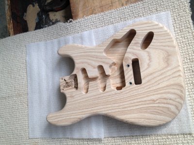

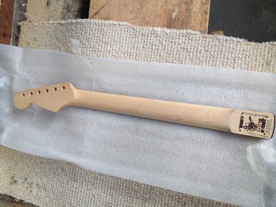

Just received a stunning one piece swamp ash body and a maple/ebony neck. I'm gonna do black stain and black grain filler on the body. Just black stain on the neck. Here it is, right out of the box:

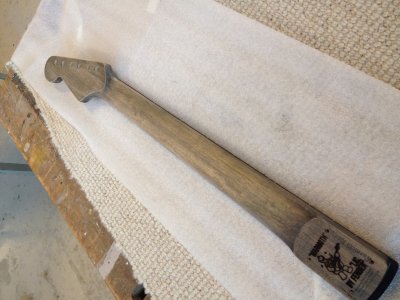

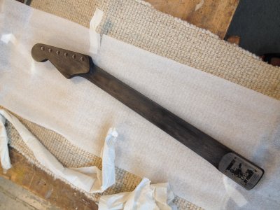

Applied some black grain filler on the neck and then sanded it down.

Yes, not too many words in me  :hello2: I just want to share my (awesome) experience with you, and maybe get some tips for my next project. I might learn something  :toothy10:

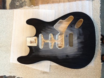

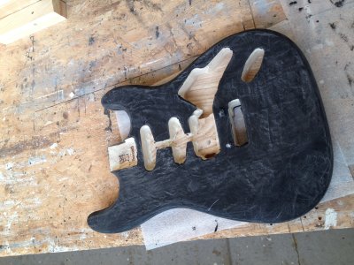

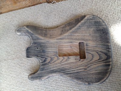

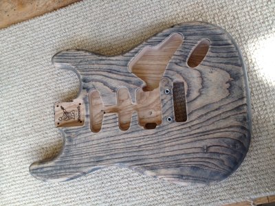

So, I did black stain on the body. Then black grain filler, and then sanded it down. I'm not sure it's the correct order, but I tried it out on some pieces of ash, before hand, and that's what worked for me and the tools and materials I had.

I see you've found black stain doesn't work well on maple necks. I did that back in the 80's for a client who wanted an all flat black stained Strat. Did OK on the mahogany body, but I ended up using black lacquer on the neck with a flattening agent in the clear coat.

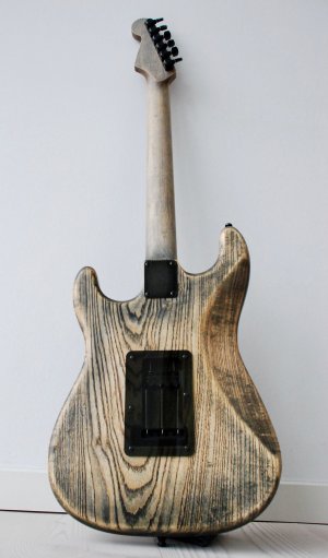

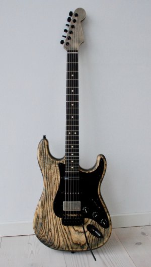

Aaaand several coats of Tru-oil, and many hours later, my first DIY finished and assembled guitar was done. I love it. It plays very well, and the frets didn't need to be leveled  :hello2:
Peace out  :redflag:

Hi. I just wanted a rough, driftwood-ish kinda look, so this was what I was going for - not an all black guitar :)
I LOVE IT!! The ''driftwood'' look is one of my absolute favorite treatments for swamp ash bodies. You definitely nailed it--ENJOY!
I'd say you captured that look nicely, well done!
Now you just need to start calling it "Zatara" (driftwood) like in the 'Count of Monte Cristo'.
That drift wood effect is really cool! Like the translucent trem cover too.
:icon_thumright:
That really does look cool. I like the way the neck and body match. Beautiful effect.
Man, if that don't look all blanketty blank cool. Very nice work.
(Gonna go back and look at the pics again now...  :icon_jokercolor:)
