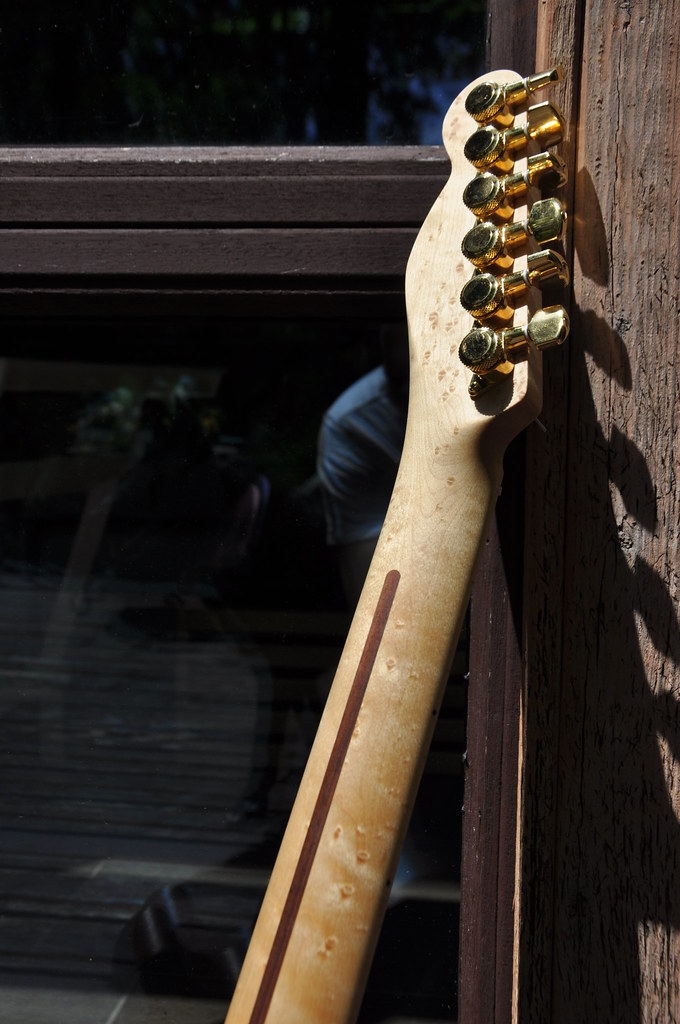

Soooo I put the last coat of linseed oil on my first body and neck right before I went to visit Portland, OR for a week. After my trip, during which I got to meet Ken and try out some pickups, there also came the conclusion that I'm not moving out there until the end of the summer.
With that in mind, I had the money to order the last of my hardware! I've got everything but the neck pickup now, and I'm waiting for that to come before I really get to it. But I had the bridge the tuning machines before and I slapped them on and strung her up so I can get a feel for things.
So far:
I haven't taken off the protective film yet, because the pickguard doesn't really meet flush w/ the bridge and I wasn't sure if it's supposed to be like that or if I should get it replaced.... What do you think?  :icon_scratch:
Let's see some backside.
I have to admit that I'm not thrilled w/ the feeling of the oiled neck. Everyone seems to rave about satin necks and raw necks, but going back to any of my gloss-neck guitars felt much better. I gotta take some 0000 steel wool to it to see if it'll feel a little smoother, because I don't think I did it after the last coat. We'll see!
Really need to get this baby set up proper - the action is a little weird and i have some buzzing spots, but I think once it's all said and done, it's going to kick some ass. It sounds and feels nothing like any guitar i've ever owned.  :blob7:

you know, it's possible. I'd be lying if i said it felt totally dry to me. i just kinda got sick of waiting. it feels fine and the finish looks even and consistent, without any sign of change on the neck or body where my skin is in contact with it the most. It was boiled linseed oil, which is supposed to dry faster than the regular stuff.
You're not alone. I like the feel of a raw neck, but can't shake the feeling that it's a festering biohazard. Then, oiled necks never feel quite right to me - they always feel like they need to be wiped down or something. A nice gloss finish feels right. Fast, clean, smooth... what's not to love? Although, I can imagine if one had particularly sweaty hands, the gloss might slow you down. But, if that's the case, then the first two situations get worse. Your neck is soaking up sweat and oil and dead skin cells and who knows what. I'm not a germophobe, but I don't like to tempt fate, either.
I sweat bullets, and the only thing I can do is play a satin or raw neck, and rub her down with steel wool frequently to get rid of dead skin and a "pseudo gloss" that seems to build up after a couple months of play.

It plays wonderfully. The frets are lower than the frets on all my other electrics, but it didn't bother me much at all. The fact is that i didn't think about playability at all when I was messing with it - which is a very good thing. The Roadhouse Hybrid Tele neck pickup sounds fudging amazing. It's exactly what I've been missing from electric guitar for so many years. It's just articulate and open and balanced and doesn't have too much of anything. And it really sounds a lot like the guitar itself.
It's got great sustain and overall a good sound. It's very even and responsive. I can't figure out why the unwound strings are missing that top end sparkle though. I had originally thought it was because it needed a string tree to get the right tension, but I installed one and it made no difference. I'll give it a few days to break in and see how it goes, but I'm definitely considering selling the maple neck and buying something else. Warmoth told me they have a few pieces of Goncalo Alves big enough to make a one-piece vintage modern neck.  :toothy10:
