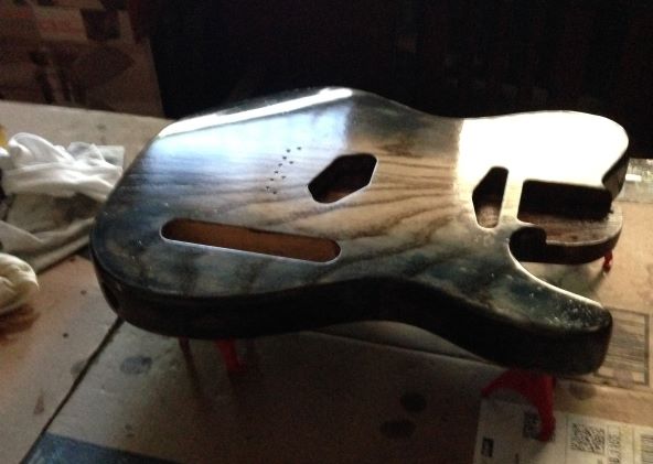

Greetings,
I've been working on my Warmoth Tele body.  I have it stained/dyed as I want it and have been applying coats of True Oil and Armor All, as listed in this thread http://www.unofficialwarmoth.com/index.php?topic=30377.0.
I have enough coats on it that a really nice gloss is starting to happen (between 12 and 18 coats a side), however, my coats aren't the smoothest.  Some areas are great, some not so great.  I took 800 and 1000 grit wet/dry sandpaper and sanded down a bit.  It helped, but not enough.
Some questions....
Do the layers smooth out by adding more coats?
I'm using the sandpaper wet, should I be using it dry?
Assuming I get the gloss look I'm going for, what is the final step?  I'm guessing some kind of polish with a polishing wheel?
Does wax get applied?
Thanks
We all have to develop our own "brand" of Kung Fu.  For me, it's dying first, then applying the tru-oil or whatever topcoat.  In between coats rub with 0000 steel wool (though for the next build I'll use one of those sponges), making sure to get any high spots.  Then CLEAN the steel wool off, first by blowing, then with a tack cloth, then with naphtha, then putting on the next coat in a dust free area dusted with a tack cloth, etc ... only when done and let the guitar dry for a month would I finish with scratch x or rubbing compound.
The good news is that tru-oil is forgiving; when I have the problem you articulated, I just sand it off with 0000 steel wool.  YMMV.
Just a follow up.....
Still sticking to the Armor All and True Oil mix.  I'm now seeing some great results.  Didn't realize the more coats, the more umpf I need to rub it in.
I'm wearing latex gloves, spritzing a side with Armor All, rubbing it even, applying a few drops of True Oil, rubbing together, then in one direction really rubbing it in, then using a lint free rag, rubbing and rubbing and rubbing.  Really starting to take on a nice gloss now.
I'm also realizing, I didn't do the best job sanding the body in prep for the dye.  But as I'm finding out, with more and more coats (have to be up to about 30 or so now), any unevenness is being filled in by the Armor All / True Oil mix and is smoothing out.
It's coming along...

It seems it isn't mentioned as often or strongly enough how important prep before finishing is, as if the finish is going to perform some sort of miracle. The reverse is much more often true - that the finish exacerbates any prep deficiencies, sometimes surprisingly so. You really need to get the thing to the point where it almost doesn't need a finish. Really, the finish is just for protection and/or to provide an unnatural aesthetic for the material, such as high gloss or color/artwork.
Yours is looking pretty nice!
