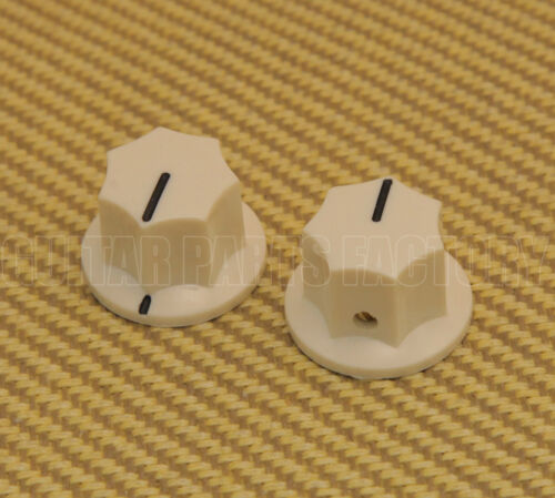

I have the neck.  I think I am going to keep the CBS shape since the vintage mustangs came that way.
I am debating two things.
1.  Should I put some amber on the neck?  I think it would look good with the Wenge fretboard.  It will also give a more vintage feel.
2.  Knobs.  This photo shows some cream knobs.  I have some black ones too.  Thoughts??
I enclosed this photo of a vintage unit for reference.  The photo of mine does not show the cream color well.  It looks more white in the photo.

Personally, I like cream-colored knobs there, but I do agree that the Mustang-style knobs are better than the Strat-style knobs.

I do like the knobs in cream.  I found a set of black locally on eBay.  I may need a set of cream too
Yeah, sometimes knobs can be like shoes - you really have to try them on for size to know if they're gonna work out. Luckily, they're usually not expensive, so the losers can go into the Drawer of Misfit Parts for some future project, or as goodwill generators for the friend who needs something that'll work RFN.
I played around with knobs for mustang, including the creme colored ones pictured above, white witch-hats, and chrome Tele knobs, but it really seems that on a 'stang, they ought to be black IMO. other than the J-bass/Jag/Mustang style knobs, I kind of like the '72 custom/deluxe amp-knob-lookin' things, -which I have installed on my 'stang currently. The control plate is wide enough to provide enough of a framing background for the larger, skirted knobs. -Plus, they might go nicely with that big CBS headstock!
I have the black mustang knobs.    Maybe I do one of each?  :o
