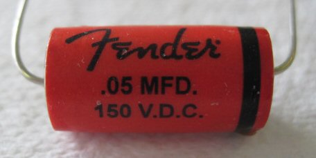

My favorite JM upper controls have a Mallory cap installed (it is so smooth and laid-back sounding!), but Mallory caps seem to "let a lot by" in other applications; all the noticeable roll-off is at the last third of the pot's sweep. Orange drops are the go-to on most of my builds, but lately, I have been using the Fender reissue waxed paper/tin foil caps. They sound really good with the Antiquity II's I put in my latest Mustang & JM (lower control pots are 250K in that one).
