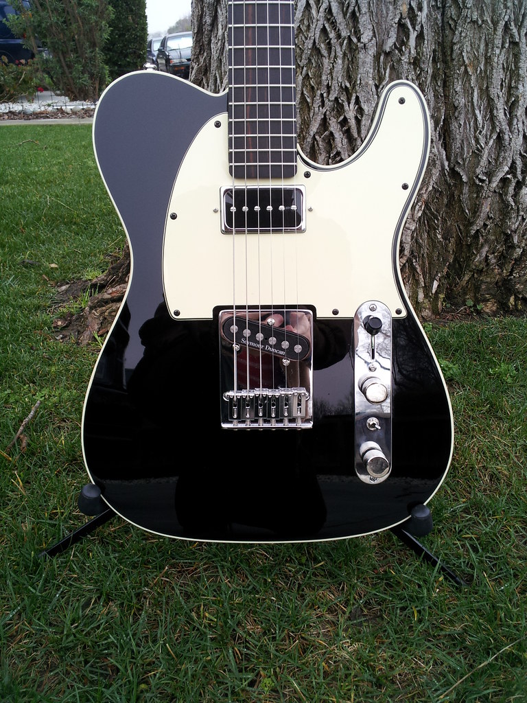

I was very happy with the mini toggle I used on Bete Noire for the tap on my Duncan Quarter Pound.  Just drilled a hole halfway between the volume and tone pot holes.  The switch never interfered with me rolling the knobs.  I'm going to use the same plate and switch arrangement when I install the Quarter Pound in another guitar.
