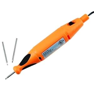

Another thing you can do that's even more inarguable is engraved IDs. They're incredibly easy to do, and the tool is surprisingly inexpensive. For instance, this diamond-tipped engraver...
... is only $15 at Amazon. Mics almost always have aluminum bodies, so they're easy to engrave, and since this unit has a diamond tip, you can even nail stands and so forth easily.
I got the idea from my dad 100 years ago, when he and my brothers and I all had to argue over whose tools were whose. Screwdrivers, wrenches, etc. that were common needed ID so you could maintain possession when somebody didn't keep track of their own stuff.
