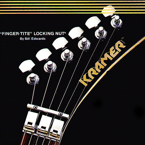

Anyone remember these?
http://www.vintagekramer.com/parts3.htm

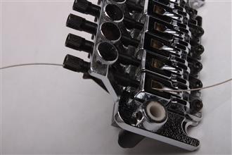

Great vid DoubleA, I agree, Floyd is no harder than a standard strat to change strings, it's all in experience. And for those in the know, Floyd does make speed loader screws that replace the SHCS in the standard Floyds and there's no snipping of the ball..
th
