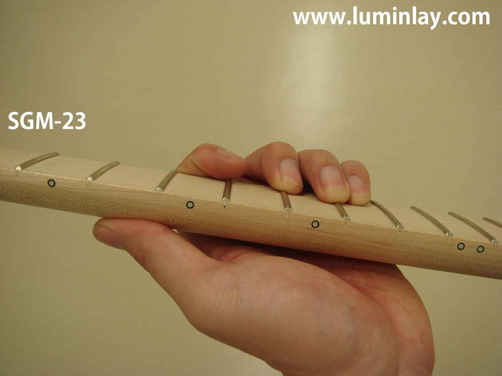

so sitting here waiting for my new knobs and had some time to kill . This neck did not have face dots or side dots , I do like no face dots but I was lost without side dots . I just so happen to have a piece of Luminlay here http://www.luminlay.com/indexen.html  and the light I got for a previous build and never used . I'm sure it's way easier to drill out an existing dot but this was a pretty big deal for me , crappy drill , wrong drill bit and so on but I went for it and I'm very happy with the results , check it out...
before , you see the stick of dot material and the mini light you get from them
I went 1 at a time and left the neck on up to the 12th fret where I had to remove it to get the drill in .
followed their install guide , sanded it and resealed it with Minwax wipe-on . And there is still a good bit left over , drilling only about 4mm in and cutting it off with a coping saw
this stuff is cool !

it makes a lot of sense for Warmoth to jump on this. Many fine builders & boutique instrument makers are just starting to use it . They could get it in bigger stock quantities and keep the price pretty attractive. Probably offer the led charger too . It would be a supply / demand thing and it seems like you guys would go for it . It looks great IMO, still effective in non glow mode and it's way less obnoxious & costly than LED's which are just too damn bright . They also make a super cool black / glow dot for light colored woods .

I'd say 15 to 20 min  as that dies down they stay faintly glowing for hours . They are only super bright right after a charge for maybe 3 to 5 min . give or take . ea dot takes about 5 to 10 sec. to charge so you should have plenty of time to get out on stage , go to your wedding anniversary thing or do a mission in ME3 .
