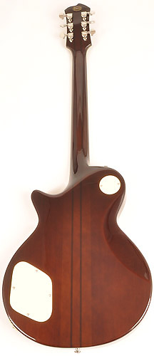

If it is a LP style guitar you want and also want the easier access at the neck joint you should consider an Agile AL-3200 model. It's a neck thru LP style:
Agile AL-3200 at Rondo
Mmmm... Agile 3200s...
Those things are so badass, I can't believe Gibson is still in business. I just got another one, similar to the one shown above but in dark blue. Just an incredible piece of work. The only problem is, they're incredibly expensive. Something that will kick a Gibson LP Custom to the curb within 2 nanoseconds of inspection will run you as much as $425 w/ a hardshell case.
