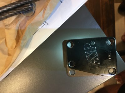

As shown in photo the upper left mounting hole is purposely closer to right upper mounting hole. No where near that side adjustment hole.

Here it is....I’m wondering if it’s just easier to order the neck pre-drilled and just drill the new hole position??

I dunno - looks pretty close to where the stock hole would be - might have to dowel and re-drill it* if you order with the screw holes.
* - but that's not a big deal.

Here’s the ESP neck mounting plate sitting directly over a Fender mounting plate. Holes lineup fine(except for the top left holes). I wonder if it’s safe to order the predrilled neck? I would only need to drill the hole closer to the right side which looks plenty far away from the Fender spec left predrilled hole.
From the looks of it, your only potential trouble spot would be whether or not the offset hole will clear the truss rod. You would have to establish center line of the Fender bolt pattern and see how far the offset hole would be clear of it. Depends on the diameter of Warmoth's truss rods. Which, unfortunately I don't know offhand.  :headbang:

Thanks!! Does anyone have these measurements??

I've done 2 Warmoth bodies where I either modded the Warmoth contoured heel ( used a Modern / Vintage neck and used a Fender Deluxe / Elite neck plate) or made my own (also used a Modern / Vintage neck and used ferules instead of a neck plate).  In both cases, I used a pre drilled neck, and in both cases I have the original hole visible from the back of the guitar.  Need to go back and fill it somehow as it is a bit unsightly.
You should be ok with the measurements you're using off of the neck plate pic you posted.  Just did a google search for the truss rod dimensions and it looks to be about 1/4"  wide (the end piece is listed as 7mm).  Go safe and measure 3/8" for the truss rod width itself.
For the position of the modified screw hole, you should be ok with both the Modern / Vintage and Modern construction truss rods.  If you were to bring the modified screw hole closer to the body (like the Fender Elite / Deluxe), you'll run into problems with the Modern construction, but since it's just slightly shifted toward the centerline of the neck, no worries.

Thanks for all that info! The back side behind the neck pocket actually flares out on the ESP body so it would cover/hide the pre-drilled hole on the upper left side. I’ll definitely measure that 3/8” off center to see if that screw hole is clear of the truss rod location. Thanks again!
