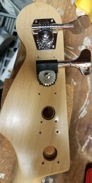

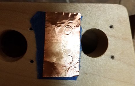

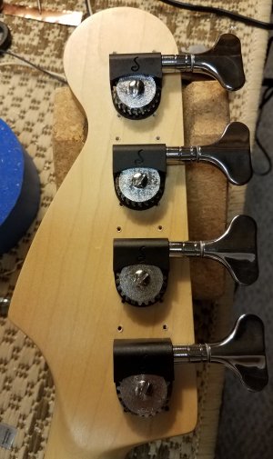

I am not sure if this is the same tuner type but I just thought I would share what worked for me. I had a hell of a time looking for some kind of jig to mount these tuners to no avail. So I just kind of winged it. Just make sure as you tighten them down to make the impression in the tape that everything is level. I have successfully done this twice. The second time I drilled the pin hole just slightly bigger. It worked even better as I was able to move the tuner a little if it wasn't perfectly aligned. You will see the holes from the previous tuners. I had a little neck dive so I went lighter and it did help.
