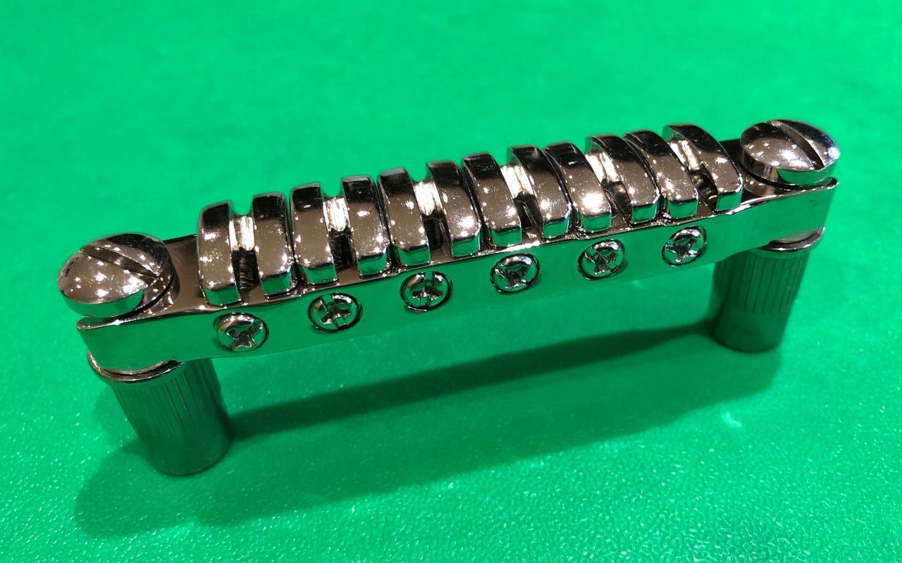

This gave rise to several problems, not he least of which is finding an 82mm TOM style bridge to mate up with the Gotoh 510 bridge insert spacing already drilled in the body. My only option appears to have one custom made. ($$$) Additionally, since a Mooncaster is considerably smaller than a Casino, I would need to buy a tail piece and have it custom modified to fit the reduced distance between the bridge and the edge of the body. I thought about doing this myself, but the mount would also need to be custom made to fit the offset angle of the body. I'm pretty sure a certain Texan could handle both jobs, but I would probably be putting his kids through college....  :icon_biggrin:

Great project. A quick search suggests that the Ibanez Gibraltar III bridge might match the post spacing. Could be a bit modern looking.
It doesn't look like the Gotoh post holes are drilled with any compensating angle, so you'd need to be sure that the saddles have enough travel.

Thanks for the link Pete. That may have been a "quick search" on your side of the pond, but over here, no so much! When I specifically searched for that bridge, after about a half hour of looking, I finally found an Ibanez model number, and the stud spacing, which is indeed 82mm. (This info is not even listed on Ibanez's site!) The European sites I scoured do not offer shipment of this item to the US. Only stocking(?) dealer I came across over here is actually mainly a drummers supply house.
Anyway, I looked at other guitars where that bridge is used and nearly all of them use it straight across rather than angled, so it definitely may meet my needs! Now it's just a question of availability. Sent an email to the dealer, waiting for a reply.

I have officially committed. Placed an order for the Ibanez Gibralter III bridge, dealer says it's a special order part, so we'll see what that means when he calls Ibanez tomorrow.... As long as it's available, I'll be perusing the the tailpiece build option.

If you don't have any luck with the bridge, there's one on ebay in the UK here. About $60 posted to the States.

Availability of the bridge is confirmed, and my order for the Ibanez Gibralter III bridge has shipped! To celebrate, and insure that I don't miss out, I also ordered the body.
