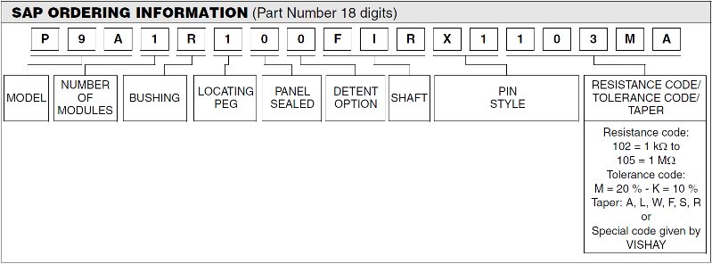

It's all over the place. For instance, from a Bournes data sheet, they list
Standard Resistance Range
Linear Tapers (A, B, E, & H) .........................(B & E) 1 K ohms to 1 megohm ......................... (A & H) 100 ohms to 1 megohm
Audio Tapers (C, D, F, G, S, & T) .................(D,G,S, & T) 1 K ohms to 1 megohm ................. (C & F) 1 K ohms to 1 megohm
From Bitechnologies...
From Vishay...
I could keep going, but it should be clear from these examples that taper designations are far from "standard", and have more variations than most people are aware of. Of course, getting some of those parts wouldn't be easy - many of them are designed for very specific applications and/or manufacturers, so they don't show up in anybody's catalog or inventory.
