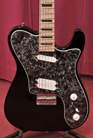

You can just open up a standard humbucking rout to fit the pickups on an angle.  On mine I wanted them to fit well at the ends, so I started with a pickguard blank and used my drill press to drill then use a rotary file to open up the holes.  Don't know why Fender never really adopted this setup instead of the conventional humbucker,  it fits the style of both the tele and strat better.  Forstner bits are your friends when doing this mod!

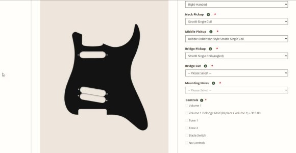

Hey all, I just ordered a Last Waltz pickguard from the big W. Here's the instructions I got from Joe in customer service:
We can offer this pickguard configuration for an additional $15.00 to the price of your pickguard.
Just specify that you would like the Last Waltz pickup configuration and understand the upcharge in the special instructions box.
I'll let you know when it arrives. I'll put this into the other thread as well.
Late breaking info (this decision was made just yesterday): you can now order the RR configuration right from the Strat pickguard builder:
